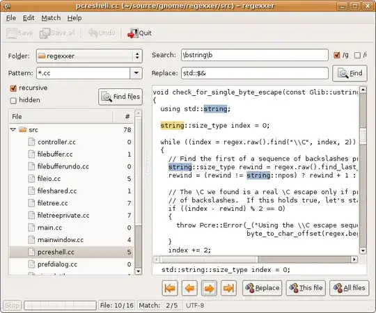

22
You can use regexxer it is a great GUI search/replace tool for regular expressions.
you can download by:
sudo apt-get install regexxer
