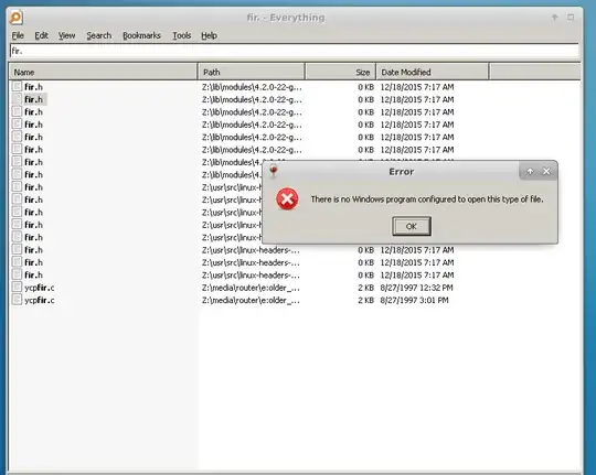

  • 2nd option: everything via wine ... roughly 5 minutes [it index even ext4 ].
Now I am a desktop user so i prefer a nice gui to search them quickly.
everything search running with wine

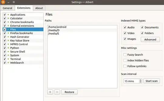

another BEST is albert. It is best keyboard launcher out there in linux community. And it has files extension that monitors your filesystem very quick and periodically.

Why do you need Wine? Is it not what you search (on Linux system)?
