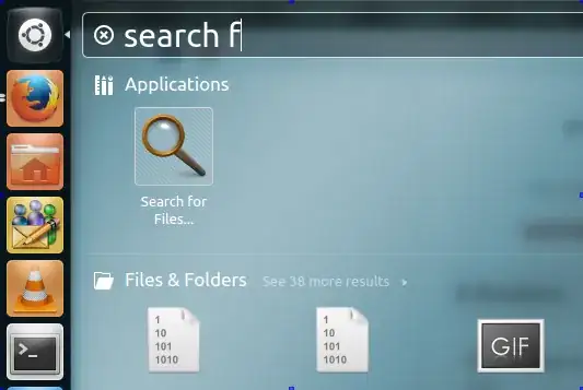

There is a very nice one that shipped with Ubuntu out of the box until 16.04. For modern releases, read the update below!
  1. Open the Dash (Super key or the Ubuntu button) and begin typing until you find Search for Files

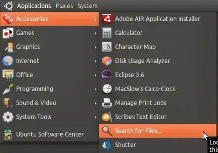

  2. The above is for Unity, the default Desktop Environment in Ubuntu. In menu-driven environments, go to Applications -> Accessories -> Search for Files

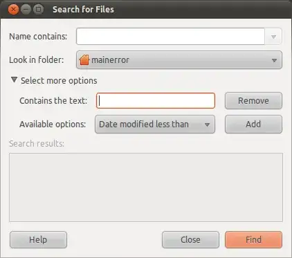

  3. Expand the Select more options section and enter the text to search for in the Contains the text: input field.
Features:
  • 100% GUI
  • You can search for file names or content
  • It does look in sub-folders.
Given your scenario (no terminal commands, simple to use interface) I think theres no better option.
PS: on the Contains the text: input field the '.' character is a wildcard. To escape it you have to use '[]'. E.g.: type Contains the text: [.]myFunction to search for .myFunction

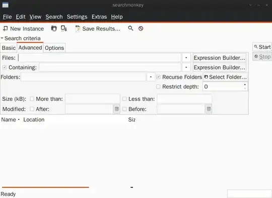

I am a fan of searchmonkey (GPL, free, cross-platform, pretty light on resources and very fast).

GUI (Graphical) tool:
gnome-search-tool
you can find it in Ubuntu main menu
Menu -> Accessories -> Search for Files
or run it using hot key ALT+F2

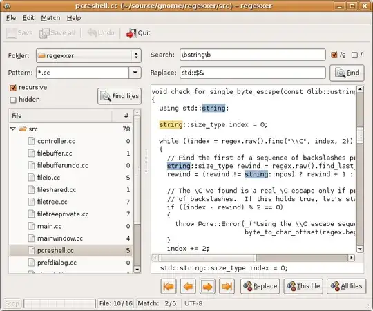

Regexxer will let you search text in files. Not sure what you mean by "in folders".

I compared three of the suggestions in here with 64 bit 16.04 Kubuntu:
  1. Searchmonkey works with 64-bit Ubuntu nowadays. It is similar to regexxer. It appeared fast, but naturally it is much slower than index based search.
