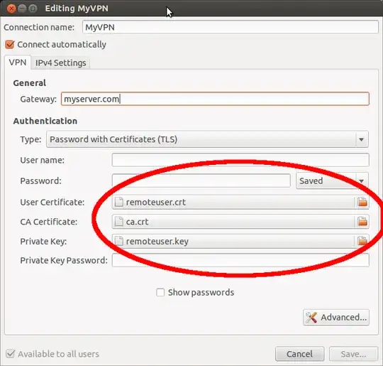

First, install the OpenVPN Network Manager plugin:
sudo apt-get install network-manager-openvpn-gnome
Open Network Manager, click "Add" and from the opened window select "Import a saved VPN configuration..." under "Choose a Connection Type". Navigate to your .ovpn file (~jrg/Documents/vpn-config.ovpn). If it doesn't automatically find your certificates/keys (the paths of which are found in the .ovpn file), you can select them here, or make any other small changes.

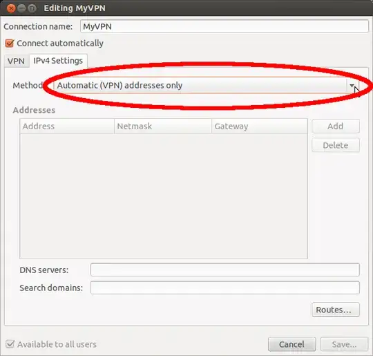

One other thing that may save you some headache down the road is to click IPv4 Settings, then change the method to "Automatic (VPN) Addresses Only". When kept at the default, this will cause ALL internet traffic to go over the VPN, regardless of your .ovpn settings. Here you can also set the DNS server and search domains to use while connected.
