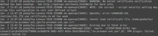

and if I check the syslog I find this error

I had to add the tls-cipher "DEFAULT:@SECLEVEL=0" because I had an other issue. So my question is how can I use network manager to connect to the VPN ?(just like the second way but with the box checked)
