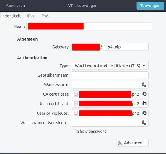

But since I need to connect to this vpn all the time I want to be able to do it using the GUI. So I'm trying to follow this guide on askubuntu, but it doesn't behave like in the screenshots. When I try to add a new vpn connection in the gui and select the option to "Import from file" and select the .openvpn file it automatically sets things up like this (UI is in Dutch, but I guess most of it should be understandable for English speakers):
The first thing that I noticed is that it selects the .p12 file for the CA-Cert, the User Cert and the User Private Key. Next to that it asks for a username and password (which I have), but also for a "Password User Key" (the last input field) of which I have no clue what it is. I tried various combinations, but I always get the same error (also translated from Dutch):
Activation of network connection failed

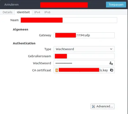

I guess the variation which comes closest to the command line option is this one:
But that gives the same error.

Turns out I had ipv6 enabled, and because it wasn't configured correctly on my laptop the whole thing broke down. After disabling ipv6 in the ipv6 tab it works like a charm.
So as a tip for future users banging their head like I did; disable ipv6 when in doubt.
