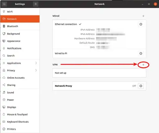

Setup VPN from Settings App
Open the settings app and go to the Network tab on the left:
Click on the + button next to VPN as shown above.

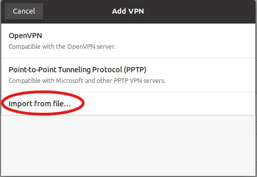

Import from file...
Select Import from file... from the Add VPN window.
Note: Do not click on the OpenVPN option above. This will ask you to fill in all sorts of things you don't need when you have the ovpn file.

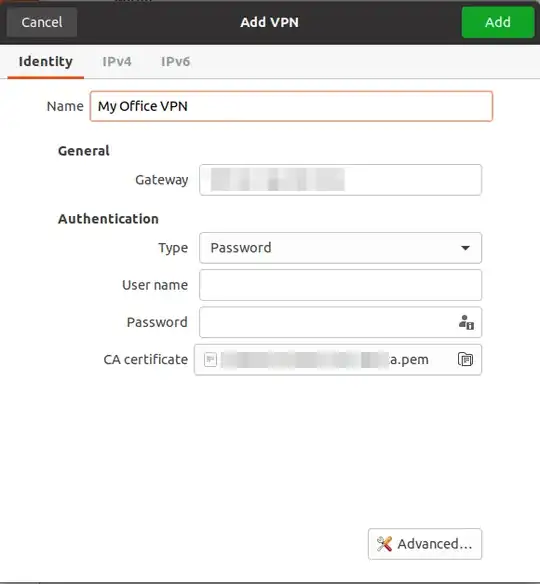

Select the client.ovpn file from your Downloads folder and open it. This will give you the next window.
Username and Password
  • The name of the VPN should be filled, but you can change it to something you want.
  • The Gateway should also be filled. Do not change it.
  • Enter your user name: user@email.com
  • Enter your Password: mypassword
  • The CA certificate should be filled. Do not change it.
Click on the ADD button. Your username and password will be saved.
