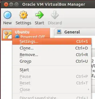

  1. Right click on the Virtual Environment you wish to edit and select **Settings*:

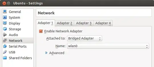

  2. Go to the Network section and select an Adapter. In this case I selected Adapter 1 although it is recommended to select a second Adapter, this way, you can use the wireless connection to your Host and still be able to connect to your internal Virtualized network (Connect to other virtualbox guests internally). For the example mentioned here I connected directly using the first adapter.
    Click on the Attached To option and select Bridged Adapter. This will open an option that will show your Host network interfaces. If your host iw Linux it will show something like wlan0, wlan, eth2... If your Host is a Mac, it will show AirPort. In the image you can see wlan0 for this case:
    Now simply accept and run your virtualized environment. You should connect and see it similar to this:

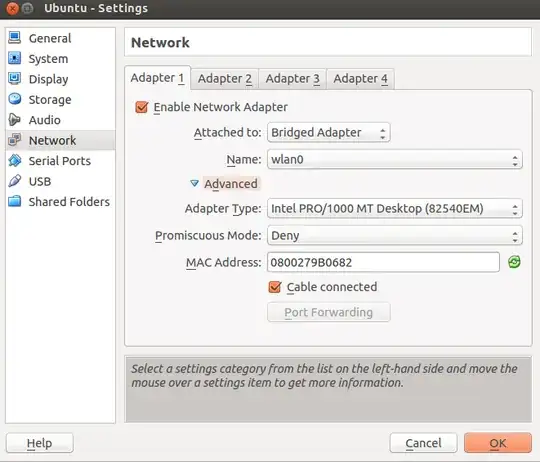

I should also mention that in the following extended options:
You can select how you wish to interpret the Host's wireless device. If you wish to see it as a Intel network device, a PcNet device or a Paravirtualized Network device. Note that Promiscuous mode is used more often for sniffing and can create a bit of network lag on both, the Guest and Host when using it.
Note that if you disconnect in the Guest OS, you are only disconnecting the Guest to Host virtualized connection. You are not disconnecting or turning off your Host's Wireless device. For more information regarding VirtualBox and networking see this guide.

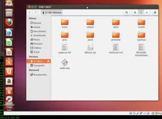

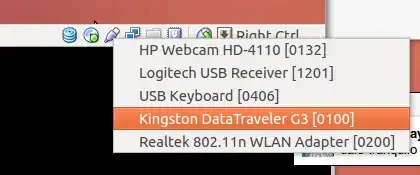

Now, if you want to access a USB device do the following (Note that you need the Extension Pack for this):
  1. Once the virtual OS has started select the device from the USB option on the bottom:
  2. It will appear on the Desktop after a couple of seconds:

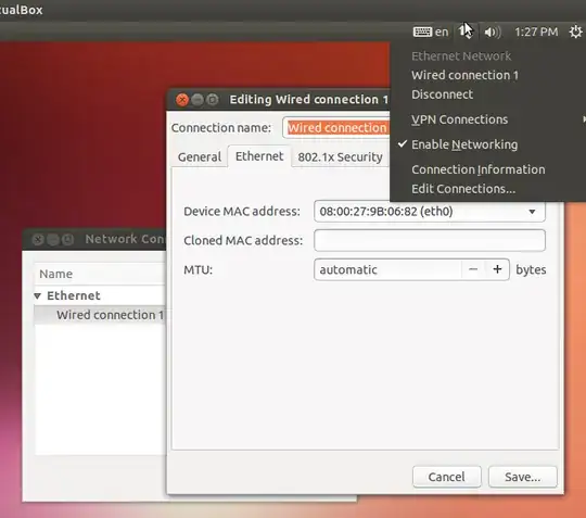

Note that VirtualBox does NOT provide a virtualized Wireless device inside the guest. They will all look like a wired one, even if the host is providing the connection via a Wired or Wireless card. Something like this:
