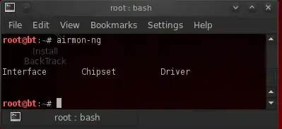

hello i'm using backtrack 5 using vmware 10 workstation .when i type airmon-ng it doesn't shows anything .

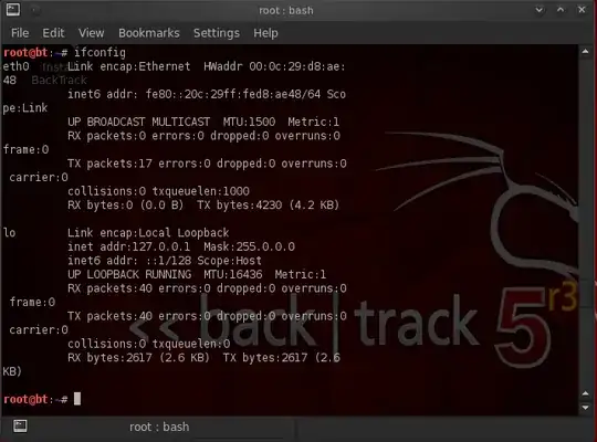

but when i type ifconfig i got following output .

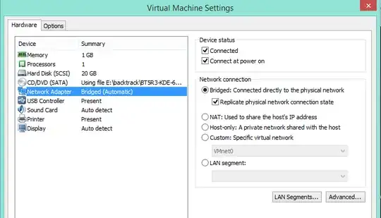

how ever i have made following network settings

But although I can provide you some help here. The ifconfig does not show any wireless device! It only shows eth0 which is a wired connection and lo which is the local loopback interface. Therefore you also can not detect any devices with aircrack. As you run BackTrack inside a VM, I think the problem is how your VirtualBox(?) bridges the physical wifi adapter to your VM.
But unfortunately I don't know about how this would get virtualized, so giving you this hint is all I can do.
