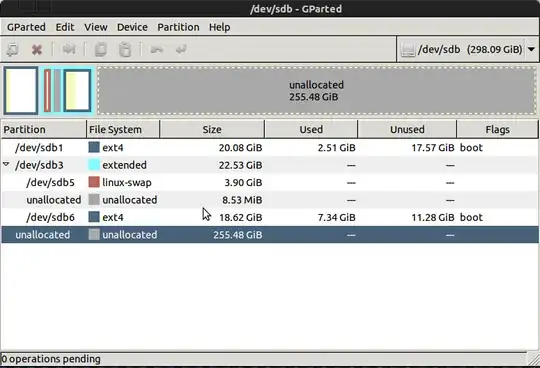

I accidentally deleted a NTFS 255 GB partition using Gparted, and yes it contains LOTS of important data.
Upon realizing the deletion I haven't yet created any file-system on it. So it still shows Unallocated.
I tried Testdisk , but it shows entire partitions created from the beginning.
This sdb is my secondary drive with Xubuntu and Kubuntu on it. And that 255 GB NTFS partition was cross platform storage drive.
I am currently in sda with Ubuntu and Win7 in dual boot, which enables me to use it as Safe recovery option rather then Live USB drive.
First , should i allocate it to ? file-System for better recovery .
Second , i really need to recover data from this drive so please give me possible suggestions and proven methods of data recovery.
Third ,does Testdisk requires deleted partition to be allocated for its recovery .
I am currently trying the answer seen here https://askubuntu.com/a/24951/63025 with Testdisk scanning for partition second time, hoping to recover it.
It looks a duplicate but i can't confirm if the OP got it right. Since my first doubt is to allocate it or not.
If any clarification required please do comment ,i will add it.

First you shouldn't allocate it, but even if you do, with RAW recovery it doesn't matter. But as I said its better not to allocate, just to make it easier.
RAW recovery means to read files without reference to any operating system. The RAW scan mode can locate the files without the aid of file system. I would recommend Ubuntu Rescue Remix.
Ubuntu Rescue Remix is a Linux Live CD. It already comes with a whole array of data recovery tools. One of them is Ddrescue. Ddrescue, is one of the best data recovery programs available and it is free. Ddrescue works by extracting a raw image of your hard drive and transferring it to another drive. It extracts data bit by bit, regardless of the file system on the drive. The reason it works even when hard drives are dying is because Ddrescue retries several times and even tries to read data backwards. The procedure sometimes can take days, but it is very effective.1
