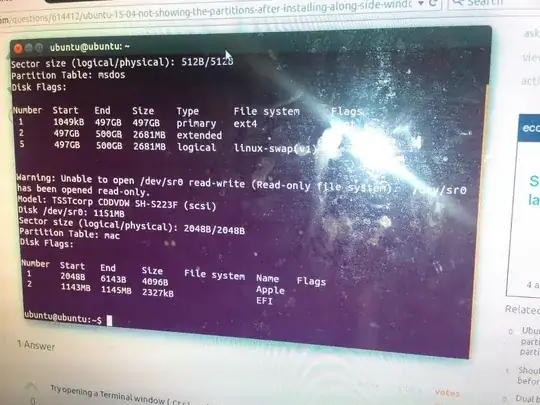

Here's the output of sudo parted -l, run from a live Ubuntu:

From the screen photo, It seems like the installer wiped your hard drive. This was a known issue before 14.04, but it should have been fixed since, according to the bug status. If it really is as you said, please file a new bug report for the Ubiquity package.

If you are using a SSD, you can basically give up all hopes. SSDs use a feature called TRIM, which erases deleted and invalid data blocks as to keep the drive fast.

You may first want to search for lost partitions. It should be TestDisk's first menu option. (Partition table Intel/PC/msdos). If you are lucky, TestDisk will manage to find the deleted partitions and gives you the option to create a new partition table. This will likely make the installed system unbootable.
When the program manages to restore the partition table (even partially), you should be able to mount the formerly lost partitions and you may find your personal files. If so, copy them to an external hard drive (the one I advised you to get before.)
