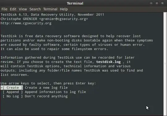

After installing ,open Terminal and run sudo testdisk to get this

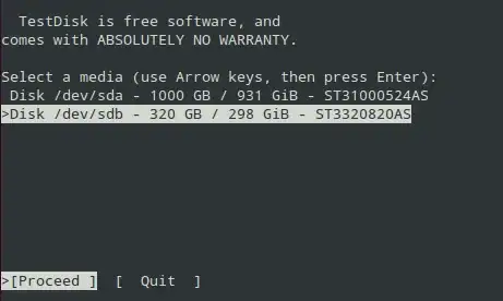

Select the create to create new log file ,select the Hard disk you want to recover , Proceed upon selecting the Disk

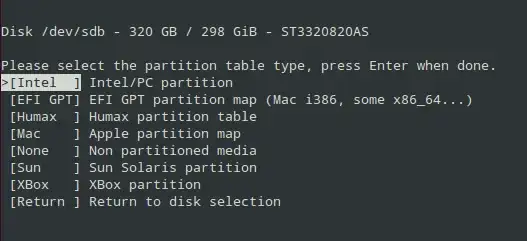

Then select the Intel option , Enter to proceed further.

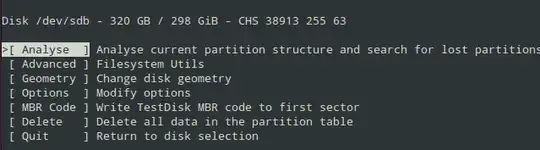

Analyse to search for Lost Partition
