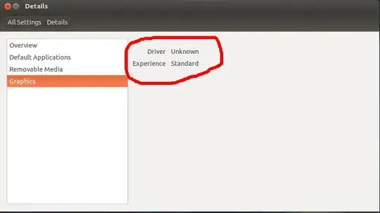

Install mesa-utils, that might work.
sudo apt-get install mesa-utils
it worked in my case. Read this question posted by me
before installing mesa-utils enter image description here
after installing mesa-utils enter image description here
