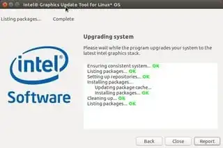

Recent update:
Recently, Intel released Intel Graphics Update Tool 2.0.2 which supports Ubuntu 16.04. Download it from here:
https://01.org/linuxgraphics/downloads/intel-graphics-update-tool-linux-os-v2.0.2

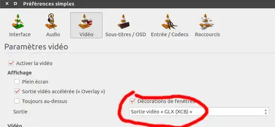

I had the same problem. I have solved it by install intel driver like below (i think it's a part of the solution ;-) ) AND chose the GLX video output in VLC setting.
