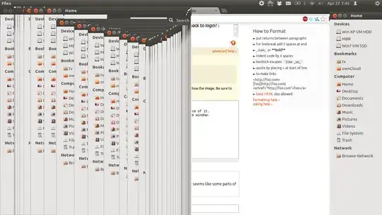

I have got a graphic problem, but I don't have a clue how to find the source of it.
It seems like some parts of the display won't refresh when I am moving a window. It also has to be some software error, as it is shown on the screen shot below.
Screen shot of the error.
The Computer is a modified version of the Dell Vostro 3450. It uses the Intel HD Graphics of the built-in Intel I5. (Some more information: 16 GB Ram, 500 GB HDD and 128 GB SSD.)
I'm running the 12.04 LTS.

It also seems to be a unity problem. I switched to Gnome classic and it runs fine. Also this problem occured just two days ago.I didn't use the Laptop for about a week, started it 2 days ago(usually its always in standby-mode, but it may have run out of power) and then recognized the error. After that i installed all updates, but the error is still there.
Okay, its gone. I ran Ubuntu-Tweek's janitor, which basically clears/removes the apt-cache, old kernels, package configuration and unneeded packages. Then i restarted unity and it looks all good.

This glitch is due to system cache accumulation. Therefore one can solve it by clearing cache. To do this one may use Ubuntu Tweak's 'Janitor' feature. For installing Ubuntu tweak use the following commands:
sudo add-apt-repository ppa:tualatrix/ppa
sudo apt-get update
sudo apt-get install ubuntu-tweak
Then open it from the dash. One can also open it from the terminal with the command:
ubuntu-tweak
Then one should select Start Janitor. Then select the cache one desires to clear from the subsequent window and then press Clean to remove cache. This should remove all unnecessary cache and solve the graphical glitch too.
If this doesn't work one may try making edits in CompizConfig settings manager which can be installed from here:
Install via the software center
