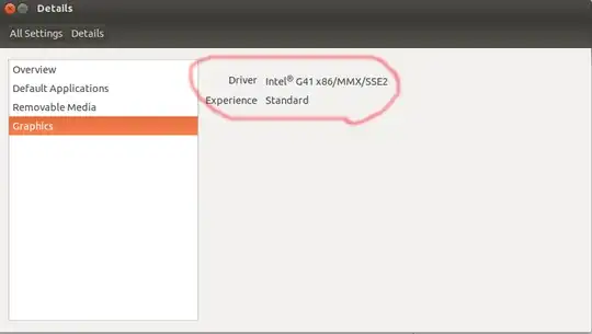

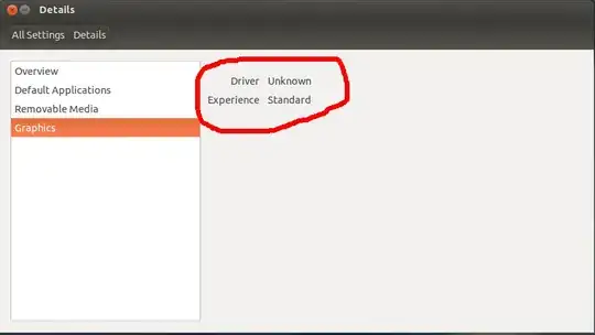

On running Ubuntu 12.10 through hard disk installation, the "details" app shows that graphics driver is unknown, as shown in the following image. enter image description here
But when running an Ubuntu live usb, which contains Ubuntu 13.04,it shows that a driver is present
enter image description here So, from this I think that I need to install the driver for corresponding graphics card, but I don't know how to.

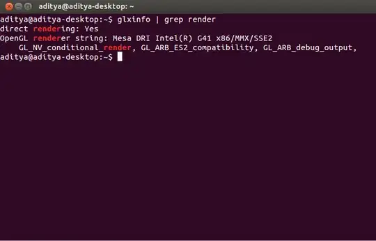

this is the output of the command
glxinfo | grep render .
installing mesa-utils worked
sudo apt-get install mesa-utils .

First of all, in the Live session (second image) you are not seeing the same Graphics tab, but the general Overview tab which doesn't show the driver in use but the Graphics card name.
Second, the driver value indicates the string value of the mesa driver. Mesa is the defacto driver to render 3D applications in Linux. This is were is took the values in the first screenshot:
$ glxinfo | grep render
direct rendering: Yes
OpenGL renderer string: Gallium 0.4 on ATI RV515
As you can read, the "OpenGL renderer string" and the "Driver" are called the same. I doubt your Intel card supports this.
