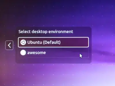

This confused me too. Once a new new desktop environment is installed using apt as described by @Mitch, then it can be difficult to see where the option is at login in the Gnome Display Manager (GDM) to select your desktop. As @DanFromGermany said, the icon is next to your login.
In this picture on 13.10, you'll see that there is an icon to the right of my login name on the GDM screen - marked with a red arrow. This icon shows the desktop that will be active when you log in.
Ubuntu icon on GDM shows desktop that will be active on login
If you click this icon, you will get a list of the desktops available on this system.
GDM desktop list shows Ubuntu and awesome desktops available
Pick the one you want and log in - that desktop should then be available.
