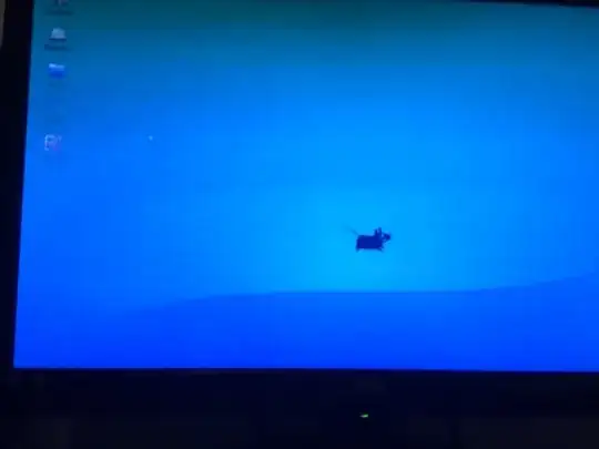

But now, I am left with a bizzare desktop environment, all my files are still there, and even my desktop files have their custom icons! yayy! but what hapened to my - stock ubuntu I might add - desktop environment and how do I get it back?
Picture of the weird environment:
That is just XFCE. XFCE is just another desktop environment for Linux.
If you want the more traditional Ubuntu desktop you can log out and then when you are logging back in, there should be a gear icon. If you click on it there should be a few options, one saying Ubuntu. Click on that, then login and you should be using your old desktop environment.
In the event that there is not Ubuntu option, you can reinstall Ubuntu GNOME by first installing tasksel by typing sudo apt install tasksel into the terminal. And then sudo tasksel install ubuntu-desktop into the terminal. After that reboot and check if there is an Ubuntu option, select it and login.
