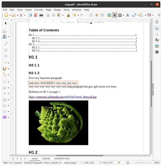

LibreOffice Draw
This impressed me:
sudo apt-get install libreoffice
libreoffice my.pdf
Just open the PDF, edit, and export as PDF.
The editing tools appear in a toolbar at the bottom of the window (took me some time to find it...)
Relevant feature set I have found so far (Ubuntu 13.04, LibreOffice 4.0.2.2):
  • Remove pages: Right click on the page on the left page list > Delete page. See also: How can I extract a page range / a part of a PDF?
  • Change page order: Drag drop pages on the page list
  • Edit existing text fields (edit text, formatting and position). Just click twice with the select tool to enter edit mode.
  • Add new text fields. Choose the text tool at the bottom (T), select the desired text area, and write.
  • Edit non text fields objects like lines or bullets.
  • Create fillable PDF forms (Enable the Form* toolbars and be sure to select "Create a PDF Form")
I could not find an extremely convenient highlight method, but you could get away with editing text attributes like setting the colour red and boldface. I could not change the background colour tough.
If I missed good features, please edit and add them!
Here is a screenshot of me editing a PDF exported from this ODT: https://github.com/cirosantilli/media/blob/f3497274fffcb043b9751c903c9fe715a5b023ce/test.odt on 6.4.6.
Of course, as you can see in the screenshot above, PDFs don't have as much information as the original ODT, and e.g. I can only edit one visible line at a time of a paragraph, and the following paragraphs won't "wrap back" to the correct size, since PDFs simply aren't designed to be editable.
Note: I know that it fails for a few type of PDFs, it has already happened to me.
If that is the case for you, please open a minimal, super detailed and reproducible bug report on their bug tracker https://bugs.documentfoundation.org/ so that devs may solve it, and post the link as a comment. When it happened to me I was lazy/inexperienced and didn't do that :-)
Despite this, it was still the best open solution when I last checked, and it works most of the time.

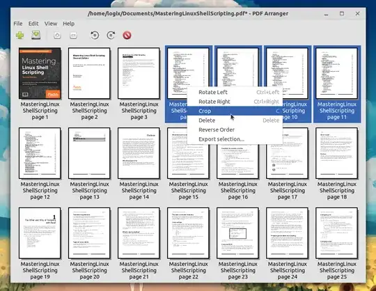

PDF-Shuffler, which was mentioned here, is very old and has some issues since it wasn't updated in a very long time (since 2012). To fix those issues and add new functionality, a fork was created, called PDF Arranger.
PDF Arranger
PDF Arranger is a free and open source application for manipulating PDF documents, that can be used to merge, split, rotate and crop PDF documents and reorder their pages, using an interactive user interface.
PDF Arranger is available in Ubuntu 19.04 and newer, and can be installed using:
sudo apt install pdfarranger
For older Ubuntu versions there's a PPA to install it (provided by Linux Uprising):
sudo add-apt-repository ppa:linuxuprising/apps
sudo apt update
