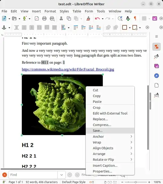

LibreOffice Draw -> Right click image -> Save
This can be convenient:
  • for those not familiar with the CLI
  • if you just want to take one image from a large document. pdfimages would require you to go over 1.png, 2.png, etc. to find the desired image
This works because LibreOffice Draw can handle PDFs as mentioned at: How to Edit PDFs?
You can open the PDF from the CLI easily with:
libreoffice doc.pdf
Tested on Ubuntu 22.04.
