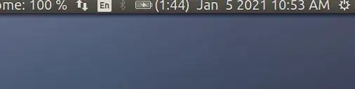

This is a working example of Mark L's Answer:
With this method a confirmation bubble is sent overlapping the top panel bar. Traditionally a notification bubble which appears lower below the top panel bar.
A notification bubble usually lasts a few seconds but in above gif the confirmation bubble is immediately replaced by the next one. The method is to call the notify-send command in a loop:
# Make volume bar using progress bar methods
VolumeBar $CurrVolume
# Ask Ubuntu: https://askubuntu.com/a/871207/307523
notify-send --urgency=critical "tvpowered" \
    -h string:x-canonical-private-synchronous:volume \
    --icon=/usr/share/icons/gnome/48x48/devices/audio-speakers.png \
    "Volume: $CurrVolume $Bar"
In above code snippet the function VolumeBar sets the variable $Bar with a progress bar based on the value passed in $CurrVolume.
