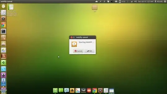

for some reason this is working in a wierd way! it shows up a dialogue box instead of notification for the part "Starting xampp.." and "Stopping xampp.." and then shows a notification of "xampp started" or "xampp stopped"... :/ the dialogue box copes up with ok and cancel buttons!

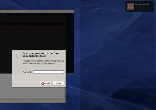

Edit This is how it shows on mine... enter image description here
