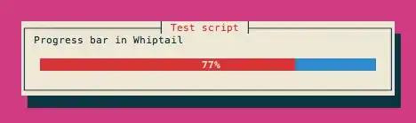

whiptail comes preinstalled on Ubuntu and many other distros, and will show full-screen (but still terminal-based) progress elements.

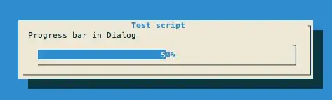

dialog is a superset of whiptail, so this example will work equally well with both. It does provide more advanced UI elements, so it may come in handy if you're looking for user interaction such as file pickers and forms, but it has the disadvantage of not coming preinstalled on many systems.
whiptail
dialog
for i in $(seq 1 100)
do
    sleep 0.1
    echo $i
done | whiptail --title 'Test script' --gauge 'Running...' 6 60 0
Note that the script output is interpreted as a percentage, so you may have to adjust your output accordingly.

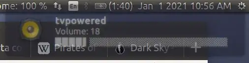

I needed a progress bar that would fit in popup bubble message (notify-send) to represent TV volume level. Recently I've been writing a music player in python and the TV picture is turned off most of the time.
Sample output from terminal
Bash script

This section details how notify-send is used to quickly spam popup bubble messages to the desktop. This is required because volume level can change many times a second and the default bubble message behavior is for a message to stay on the desktop for many seconds.
Sample popup bubble message
Popup bubble message bash code
From the script above the main function was copied to a new functioned called VolumeBar in an existing bash script called tvpowered. The exit 0 command in the copied main function was removed.
Here's how to call it and let Ubuntu's notify-send command know we will be spamming popup bubble message:
VolumeBar $CurrVolume
# Ask Ubuntu: https://askubuntu.com/a/871207/307523
notify-send --urgency=critical "tvpowered" \
    -h string:x-canonical-private-synchronous:volume \
    --icon=/usr/share/icons/gnome/48x48/devices/audio-speakers.png \
    "Volume: $CurrVolume $Bar"
This is the new line which tells notify-send to immediately replace last popup bubble:
volume groups the popup bubble messages together and new messages in this group immediately replaces the previous. You can use anything instead of volume.
