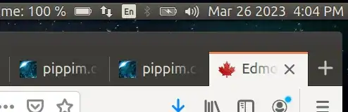

HomA (Home Automation)
As of February 10, 2025, HomA was released to replace tvpowered bash script below. HomA is written in python and automatically discovers the same devices that you must hard code into tvpowered below. Additionally HomA supports Bluetooth Low Energy (BLE) LED Light Strips and automatically shuts them off when system is suspended.
Sony TV remote suspends laptop
This answer is based on IoT (Inernet of Things).
tvpowered (TV controls power to the computer) is a bash script. When you press the power button on your Sony TV remote:
  • The Sony TV will be shut off
  • The Google Android TV will be shut off
  • The light behind the Sony TV will be shut off
  • The light behind the Google TV will be shut off
  • The laptop will be put to sleep
Additionally the tvpowered script will:
  • Turn off picture of TV to save power when you are not watching movies on TV.
  • Display pop-up bubble when you change volume of TV used for listening to music.
Please note this only works with Sony Bravia TVs.
