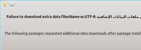

After fresh install 12.04 I && updating apt and system restart, I always get this annoying message after reboot :
Failure to download extra data files
The following packages requested additional data downloads after package installation, but the data could not be downloaded or could not be processed.
ttf-mscorefonts-installer
The download will be attempted again later, or you can try the download again now. Running this command requires an active Internet connection.
But if I run attempt now, it shows flashing terminal window and like nothing happen. It'll happen again when I restart system.

(I had the same problem but with even one more package in the message: flashplugin-installer) this is the annoying message I get every start: enter image description here
The whole message is very long, rightklick to download it: this is the annoying message i get every start
Maybe you have to restart the system before install the ubuntu-restricted-extras
