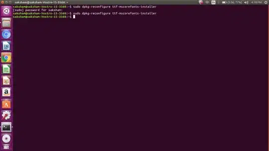

The command is giving no results sudo dpkg-reconfigure ttf-mscorefonts-installer
i referred to the solution 2 of this answer here https://askubuntu.com/a/168377/640457 but the command is giving no output. Kindly help
I'm on ubuntu version 16.04 LTS

I had OK with this Answer, https://askubuntu.com/a/858620/640587.
wget http://httpredir.debian.org/debian/pool/contrib/m/msttcorefonts/ttf-mscorefonts-installer_3.6_all.deb
sudo dpkg -i ttf-mscorefonts-installer_3.6_all.deb
After finish running these command in terminal, check on an editor like as LibreOffice. You can find Microsoft font such as Arial, Comic Sans MS and so on.
