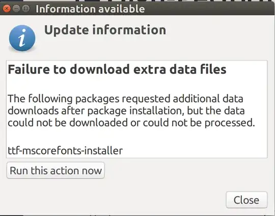

I keep getting the dreaded failed To download extra data files error in relation to ttf-mscorefonts-installer:
screenshot1

The specific point at which it fails to download changed - it seems to be a sourceforge reliability problem, but this has now been going on weeks and results in annoying popups as above all the time.
How do we get this fixed and/or how can I work around it for now.
