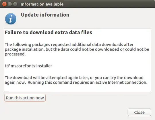

I am trying to install Windows font on Ubuntu 16.04. It says package has installed when I try to reinstall the same package but fonts are not found on LibreOffice. Also, while installing it gives some error.

Setting up ttf-mscorefonts-installer (3.4+nmu1ubuntu2) ..
I followed this step. There still some Warning (W) was visible but No Error (E). Warning is basically this:
W: Can't drop privileges for downloading as file '/var/lib/update-notifier/package-data-downloads/partial/webdin32.exe' couldn't be accessed by user '_apt'. - pkgAcquire::Run (13: Permission denied)
But after the steps mentioned in the link, I can see Window Font appear in LibreOffice font selection list.
Old Update Information Dialog Box still came. Not sure if it is coming due to old process or due to this one.
Do I need to take any more steps or everything is fine?

It's two things mixed up:
"Can't drop privileges..." is a warning, which you can just ignore. That warning is usually followed by a confirmation that the file was downloaded.
However, the attempt to fetch arialb32.exe was a real failure ("Hash Sum mismatch"). May be caused by a temporary server glitch; you can try again by reinstalling:
sudo apt install --reinstall ttf-mscorefonts-installer
Regarding ttf-mscorefonts-installer I thought I'd share since I spent a few minutes on it when upgrading to yakkety. I experienced both the the not-signed EULA, lack of priviliges and hash sum mismatch, strangely not all at the same time. All cured by :
chown _apt /var/lib/update-notifier/package-data-downloads
chown _apt /var/lib/update-notifier/package-data-downloads/partial
rm /var/lib/update-notifier/package-data-downloads/partial/*
What package maintainer that has the key to get this right I don't know.
