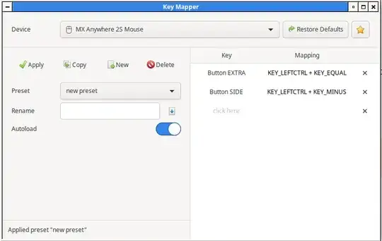

The best answer in 2021 is Input Remapper (formerly Key Mapper):
https://github.com/sezanzeb/input-remapper
No more hacking required.
2023 update:
One potential problem with this tool is that it installs a background service that registers a dummy game controller to achieve the key mapping functionality.
Unfortunately, this can trick some games to use that controller instead of mouse & keyboard. This can (rarely) cause some games that don't have internal controller settings to become unplayable until this service is shut off.
You can temporarily disable the remapper service using:
sudo systemctl stop input-remapper.service
Re-enable with:
sudo systemctl start input-remapper.service

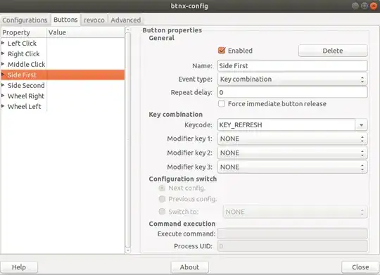

You should already have these as they should come with Ubuntu, but run this just in case.
sudo apt-get install libdaemon-dev libglade2-dev libgtk2.0-dev
Now, download & install
  1. btnx-config
  2. btnx In this order.
To install:
Unzip, and cd into each of these folders.
In each of them run:
./configure
make
sudo make install
Once both of them are installed, run
sudo btnx-config
In Configurations tab, click Detect Mouse & Buttons
In Buttons tab, assign your mouse button a key or functionality. Make sure you ☑ check mark enabled.
Lastly, in Configurations tab, click on Restart btx button so your changes take effect.

I think https://github.com/sezanzeb/key-mapper will most likely be able to do it in that case.

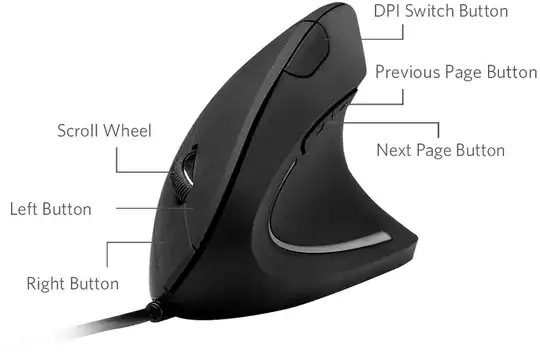

Scroll up and down with mouse forward and back buttons
First, install the required packages:
$ sudo apt install x11-utils xbindkeys xautomation
Next, use xev provided by x11-utils to detect the exact button numbers of the back and forward buttons of the mouse.
$ xev |grep -A2 ButtonPress
For my wired vertical Anker mouse, back and forward are respectively buttons 8 and 9.
ButtonPress event, serial 37, synthetic NO, window 0x3600001,
    root 0x1da, subw 0x0, time 1708382, (68,54), root:(939,498),
    state 0x10, button 8, same_screen YES
    root 0x1da, subw 0x0, time 1711030, (69,48), root:(940,492),
    state 0x10, button 9, same_screen YES
