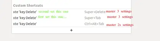

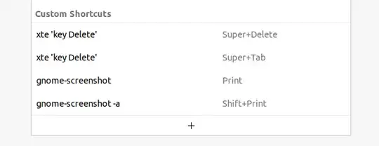

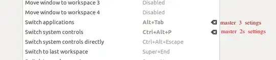

This is instruction for Logitech Master 3. I have switch from master 2s. I tried to make delete on my palm button.
For Logi Master 3, I first set
xte 'key Delete' -> Super+Tab (by simply clicking the thumb button in that dialogue)
then I repeat same operation. Just this time by clicking on thumb button I get
xte 'key Delete' -> Super+Delete
...................... 2 years later after ubuntu reinstall I had to use this enter image description here
