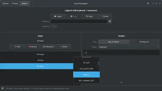

input-remapper
An easy to use tool to change the behaviour of your input devices.
The most comfortable solution I found is input-remapper. This application allows you, to map mouse buttons to shortcuts. I for example use it to switch workspace with the left and right click of my scroll wheel, what fits particularly good with the horizontal layout of workspaces in GNOME 40+:
screemsjpt
As you can see, the program comes with a GUI.
You can download an official DEB packages from here, or installed from terminal on 22.04+.
