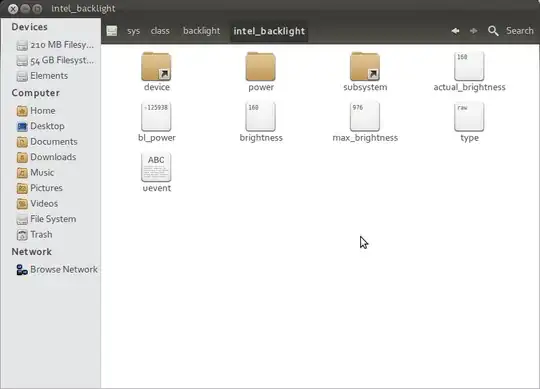

Then I found that I don't have a folder named acpi_video0, but a folder called intel_backlight:
screenshot of /sys/class/backlight/intel_backlight in Nautilus
Every time I increase or decrease the brightness using the brightness control keys, the values in brightness and actual_brightness get updated.
Is there any method I could follow to set the brightness to a fixed value on every boot and vary it as and when I need it using the brightness control keys?

#bits.
#By default this script does nothing.
#if you are changing the default brightness in Ubuntu 14.4 LTS
#the brightness under the folder acpi_video0 is important.
#Because brightness is set from that folder and not from intel_backlight
#(in case of my PC. It may very in others)
#That means you can omit the first echo line.
#However the command lines are given if any one has some problem and doesnot
#have the acpi_video0 folder
echo 1020 > /sys/class/backlight/intel_backlight/brightness
#Under the above given address the range of brightness is from 0 to 4648.
echo 3 > /sys/class/backlight/acpi_video0/brightness
#Under the above given address the range of brightness is from 0 to 7.
exit 0
