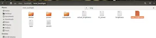

Now go to /sys/class/backlight/<folder> (my folder is intel_backlight)
screen shot of the folder
In this folder you can see the actual_brightness file and the max_brightness file. (If you have made any changes to the brightness after opening this file, don't forget to refresh (using Ctrl+R or F5) to see the actual current settings.)
