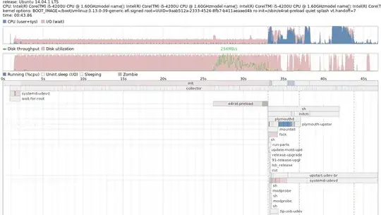

Then all of a sudden, for no (obvious) reasons it took 20sec longer again. The change actually happened from a boot at ~1am compared to a boot the next morning ~9am. Ever since, it's been stuck at the 45sec mark.

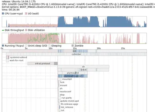

I tried to look at my boot-charts and you can actually see that before e4rat-preload started at ~5secs in the boot-process and now it starts at ~25secs. The strange thing is: from 5 until 25secs there is nothing at all happening, at least according to the bootchart. In the boot process e4rat-preload is taking incredibly much time now at the point where it says loading I-Nodes. That part was a lot faster before.
If anyone has any idea on how to fix this, I'd be more than happy. Thanks in advance for your effort.!
Here are the before/after bootcharts. I cut them a little, to show the important part in the beginning. Apart from that, they look very much similar. If it helps I can of course add the whole charts. (obs: it really was the same day, without any major updates etc.)
