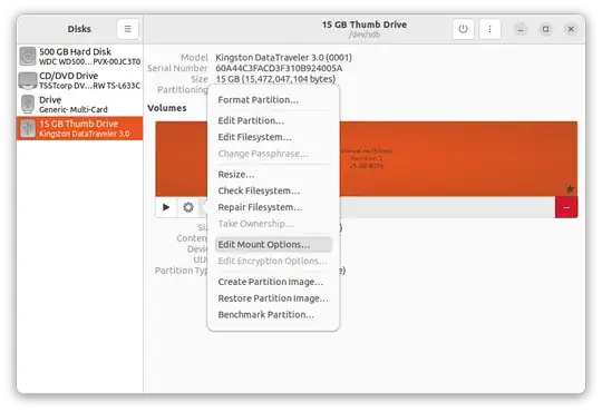

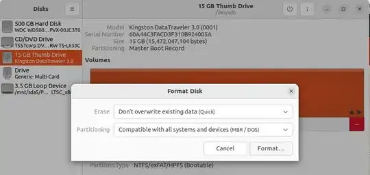

1- prepare the USB drive by disks utility:
format the -16 gb- USB disk by disk utility, choose (MRB/DOS), creat NFTS partition this very usfull fore files > 4 gb, flage the partition to bootable.

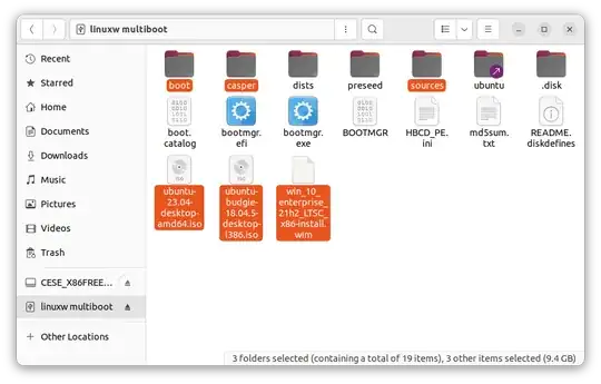

3&4- copy your iso files and other folders to the USB drive and edit boot menu:
at the first copy one Ubuntu ISO file to USB drive root directory, open your text editor and write the new boot/grub/grub.cfg or copy one from any Ubuntu ISO and edit it to make your new boot menu entry. as a example i started my work by Ubuntu budgie ISO and my grub.cfg seems like this:

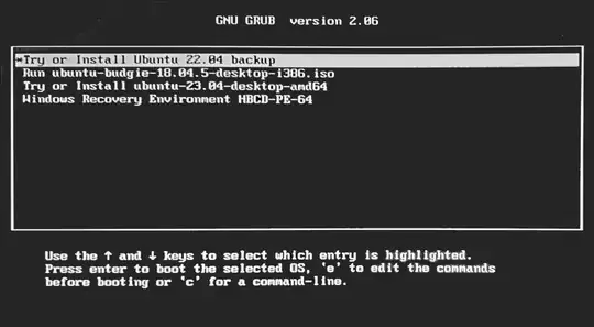

save the `grub.cfg` file and reboot by your USB drive to test your work, you can login to the first ISO, continue copy the second ISO and add the new menu entry.

Now we will try to copy folders from Ubuntu 22.04 ISO to our USB drive root and add menu entry to boot from this folders, you will copy all ubuntu 22.04 folders except boot folder. our new entry will seems like this;

note: all of this menu entrys will boot directly to try or install ubuntu except 23.04 adjusted entry will boot to install ubuntu.
Feel free to choose other version and reboot by USB drive to test your work.

Copy all folders -except boot folder just copy its enternal files to boot folder- from hbcd-pe-64.iso to the USB drive root and add this menu entry:

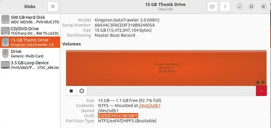

Replace 55DD0595418E5BFC by your USB drive uuid that can be known from disk utility.

Extract /sources/install.wim from Windows ISO to you USB drive, if you want multi Windows versions you will rename any new extracted install.wim so you will be informed which file to install.
