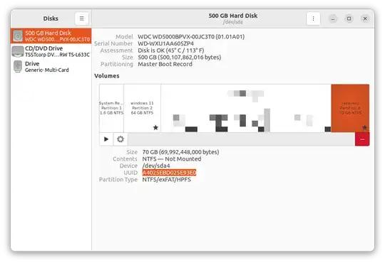

1- prepare the ntfs partition by disks utility:
creat and format -16 gb- nfts partition by disk utility, this very usfull fore files > 4 gb.
flag the partition as bootable is optional.

Replace `A4025EBD025E93E0` by ntfs partition uuid that can be known from disk utility. [![enter image description here][2]][2]

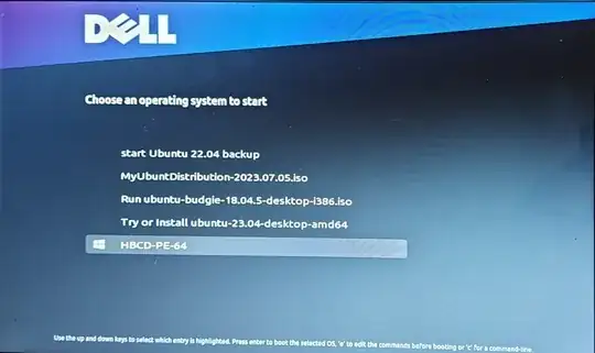

Our last entry will be about another OS like Windows or HBCD PE 64 which builded on Windows 10 64 bit, this very useful tool to repair and install any Windows on your hard disk, with this entry you will need to one file from any Windows ISO and no need to boot by Windows ISO file to fix any problem or make new installation.
Copy all folders -except boot folder just copy its enternal files to boot folder- from hbcd-pe-64.iso to the ntfs partition root and add this menu entry:

if you dont want HBCD you can replace it by any windows 7/8/10/11 files from iso file by the same way but just chang menu entry name, dont chang any other thing. by this way you can boot by other partition if you have, let we say another windows version files from other partiton.

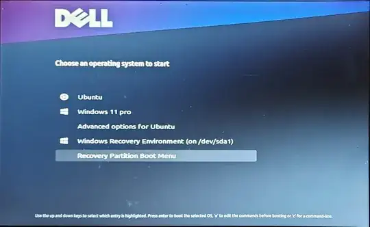

**4&5. add ntfs recovery partition boot menu to main boot menu as a separate menu and test your work** go to `/boot/grub/grub.cfg` in ubuntu root and add this entry:
menuentry "Recovery Partition Boot Menu"{
           insmod part_msdos
            insmod ntfs
            set root='hd0,msdos4'
            if [ x$feature_platform_search_hint = xy ]; then
              search --no-floppy --fs-uuid --set=root --hint-bios=hd0,msdos4 --hint-efi=hd0,msdos4 --hint-baremetal=ahci0,msdos4  A4025EBD025E93E0
            else
              search --no-floppy --fs-uuid --set=root A4025EBD025E93E0
            fi
           configfile /boot/grub/grub.cfg
save the file, Feel free to reboot and test your all your new menu entrys. also if you dont know how to edit the main grub.cfg file you can add this entry by grub-customizer like this image:
