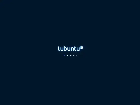

I am making a custom distribution, and have a question about the Ubuntu Logo with 5 dots displayed when booting up.
The Ubuntu-Logo-Script in the /lib/plymouth/themes/ubuntutext folder has the word Ubuntu and beneath that 5 progressing 'dots'. Is it possible to remove the progress bar dots, and instead replace it with a faded Ubuntu logo, that gradually colors up to full?

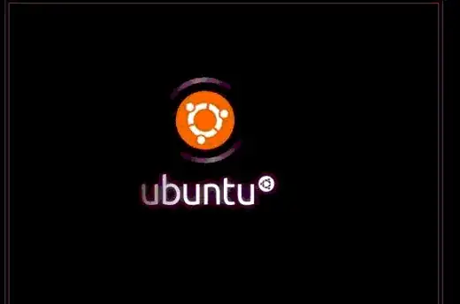

I have created theme as you wanted with a faded Ubuntu logo (moreover I have added an animation of the Ubuntu logo. Hope you'd like it :-P )
Screenshot
Spinning Ubuntu logo and the Ubuntu text logo with a moving fade effect.
