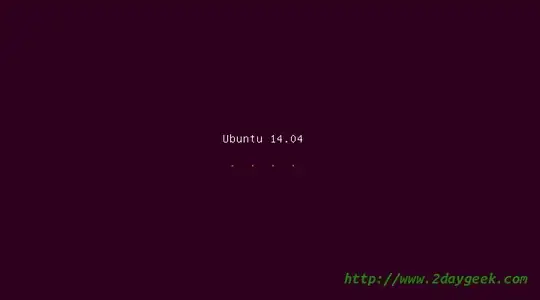

I am wondering how to change the text that displays "Ubuntu 14.04 . . . ." on boot to a custom text.
Edit: I am talking about the ASCII text during the boot process, not the Ubuntu logo.

I don't recommend it, but if you really need to customize the OS entry in the GRUB menu you just need to open (with sudo) the file /etc/default/grub and look for the line
GRUB_DISTRIBUTOR=`lsb_release -i -s 2> /dev/null || echo Debian`
You should replace
with the custom string you want.
Don't forget to run
sudo update-grub
after changing the file.
