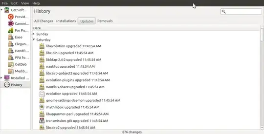

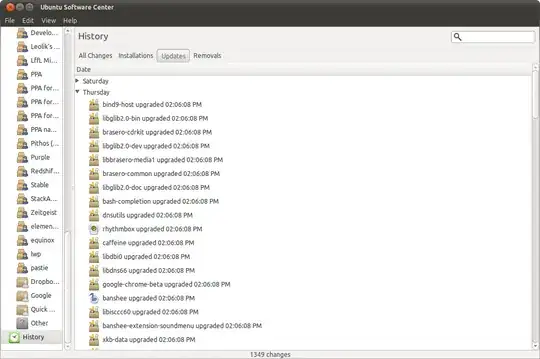

In 10.10, Ubuntu Software Center has a list of all the updates you have downloaded in the past.

It's now possible to do this through the software center as well! Go to History and you can display all of your updates and installations.
Software Center History
