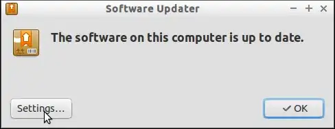

To check your settings, run the Software Updater [Update Manager for people using old versions of Ubuntu] and click Settings.... You might have to wait for it to automatically check for updates, before being able to do that.
Click Settings... in the Software Updater.

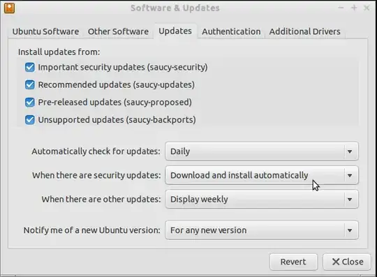

The Software & Updates window is shown (called some different things on some other versions of Ubuntu). Under "Install updates from:", there are checkboxes for the different kinds of updates that can be installed. At least "Important security updates" should be checked, and you probably want "Recommended updates" as well.
Under that, you can choose how often to check automatically for updates, what to do when new security updates are found, and what to do when other (non-security) updates are found. If you have something relatively frequent chosen for "Automatically check for updates" and you have "Download and install automatically" chosen for "When there are security updates:", then most likely any important security updates are being installed behind the scenes for you.
But if you have "Never" selected for "Automatically check for updates," then you're not getting updates installed or even checked for automatically.
Updates tab
