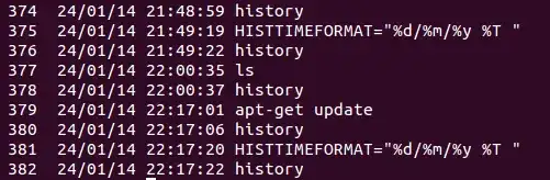

You can check your command history in terminal :
history | grep 'apt update'
To check it by time :
HISTTIMEFORMAT="%d/%m/%y %T " history | grep '[a]pt update'
(The [a] part of the regular expression only matches the letter a but has the effect to not match itself when grepping in the history.)
Terminal history with timestamp
