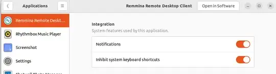

I have selected the "capture keyboard" item in Remmina. You can see it is selected in the following image. capture keyboard
After selecting that item I received a very confusing warning about inhibiting system keyboard shortcuts.
I found the setting in Settings...Applications...Remmina but I'm still confused about what it means.
remmina settings
I've turned that setting on & off and tried sending Alt-Tab to the remote computer and it doesn't work either way.

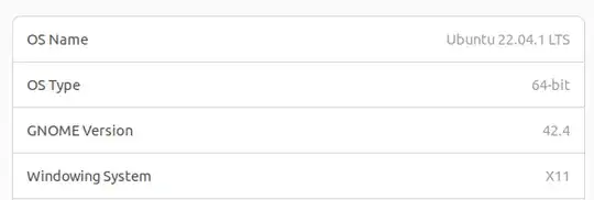

UPDATE - Definitive Answer
I was attempting to resolve another problem on 22.04 and I moved my window manager from Wayland to Xorg -- see that problem / resolution here.
After I made the change to Xorg (from wayland), I can now successfully send the ALT-TAB combination in Remmina to my remote desktop (win10). Everything works now that I've moved away from wayland.
Use X11 not Wayland.
My Ubuntu 22.04 setup
