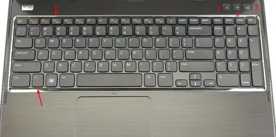

  1. How do make 2 finger scrolling work + 2 fingers zoom in & zoom out work
  2. How to Fn + f3 To lock touchpad
  3. How to configure 1 2 3 as shown in pic
    3.1 For Ubuntu Software Center
    3.2 For System Settings
    3.3 For Screen Off

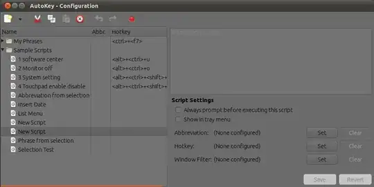

Step 1 :

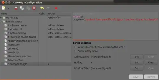

Press Ctrl+Shift+N or from File > Create.. > New Script. Rename with whatever you like.

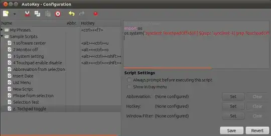

paste below code as shown,
import os
os.system("synclient TouchpadOff=$(if [ $(expr `synclient -l | grep TouchpadOff | cut -f2 -d =`) -eq 0 ]; then echo 1; else echo 0; fi)")

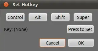

Then in bottom-right corner there is three Set buttons to set for Abbreviation or Hotkey or Window Filter. Click second Set button (because we want to set hotkey).
Click Press to Set and hit a key you want to assign(in your case fn+f3. I'm hitting fn+f1).
Click OK.
Click Save in bottom-right corner.
Now you will see your hotkey in left panel in HotKey column (in my case there is weird key like I because I have assigned fn+f1).
you have set hotkey for touchpad to enable/disable ( I have coded to make it toggle rather than just use to lock it. Perhaps you'd like it :-) ).
==> Go to Step 1 described above.
just use this code when you paste.
import os
os.system("/usr/bin/software-center %u")
and set hotkey for 1 you have shown in screenshot.
thats it you have bound 1 for Software Center.
import os
os.system("gnome-control-center")
and set hotkey for 2 you have shown in screenshot.
thats it you have bound 2 for System Settings.
3.3 For Screen Off
import os
os.system("xset dpms force off")
and set hotkey for 3 you have shown in screenshot.
thats it you have bound 3 for Monitor off.
