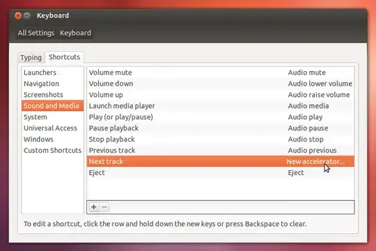

In your special case go to System SettingsKeyboardShortcutsSound and Media. Click onto "Next track ... Audio next" and press your email key:
edit shortcuts
This is the right place for connecting keys or key combinations with actions; it is possible to set up custom commands, too.

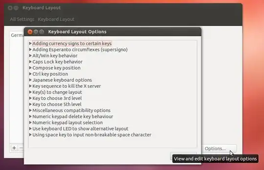

If you wish to configure several keys on your keyboard, go to System Settings and check out Keyboard LayoutOptions. There you can edit the Caps Lock behaviour, for example:
keyboard layout
