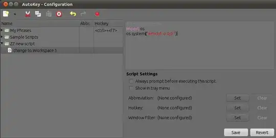

Press Ctrl+Shift+N or from File > Create.. > New Script. Rename with whatever you like.
Step 2 :

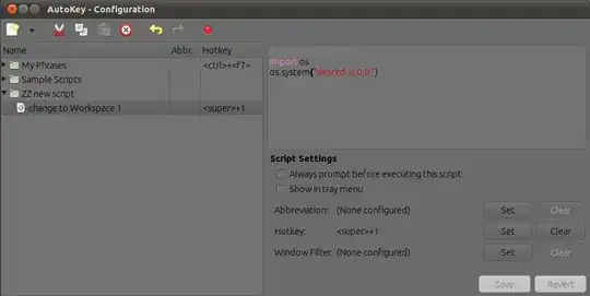

Paste below code as shown, I'll bind Super+1 to Workspace 1. Replace wmctrl -o 0,0 with your command.
import os
os.system("wmctrl -o 0,0")

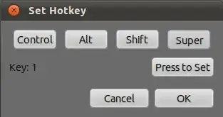

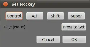

Then in bottom-right corner there is three Set buttons to set for Abbreviation or Hotkey or Window Filter. Click second Set button (because we want to set hotkey).
Step 4 :
Click Super then Click Press to Set and hit a key you want to assign(in your case 1. I'm hitting 1).
Step 5 :
Click OK.
Step 6 :
Click Save in bottom-right corner.
Try hitting Super+1.
