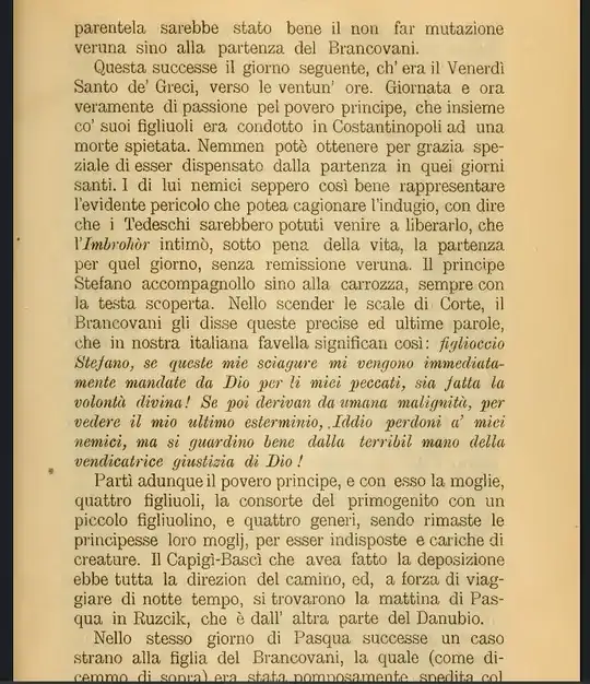

The first are formed of images that look like pictures taken of book pages:
or
Such copies can hardly be re-printed on paper, as the background will be printed too.

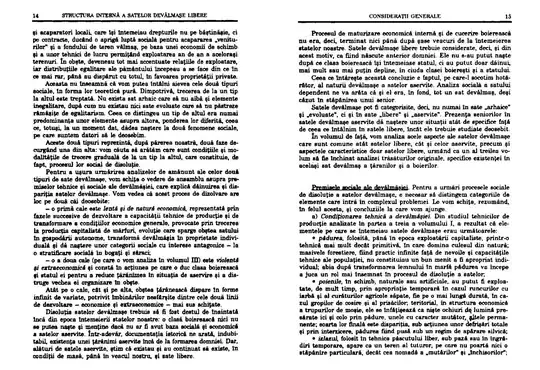

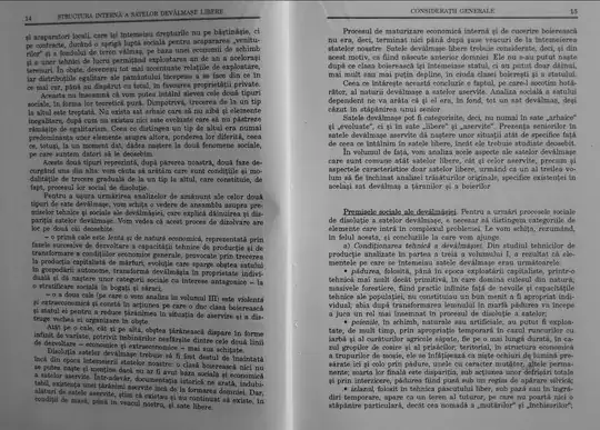

The second ones are what one would expect from scanned text, and can be printed:
or

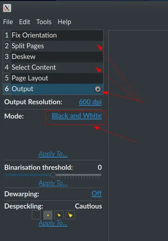

About Scan Tailor, as a complement to the main answer
Even its icon illustrates the fact that it is intended exactly for what is asked here:
![enter image description here
Here is how to use Scan Tailor with pdfs:

  1. Load and process the resulting images in Scan Tailor. Put resulting image files in a separate folder and add that folder under New Project>Input Directory in Scan Tailor. (I have installed that program from PPA, as said in a comment by @N0rbert under the main answer.) Some pages containing real images and not text might look better if for each of them is selected "Grayscale and Color" instead of the default "Black and white" (meant here for text). Run one by one the listed procedures. Check the pages before running the last one ("Output").

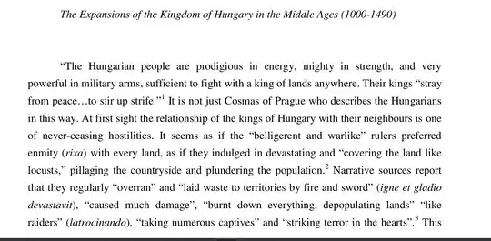

I've got pretty good result using imageMagick and the following script http://www.fmwconcepts.com/imagemagick/shadowhighlight/index.php
Here is the result using the following parameters:
./shadowhighlight -ma 100 -sa 100 -ha 00 -hw 0 -bc 20 inputFile.png OutputFile.png
