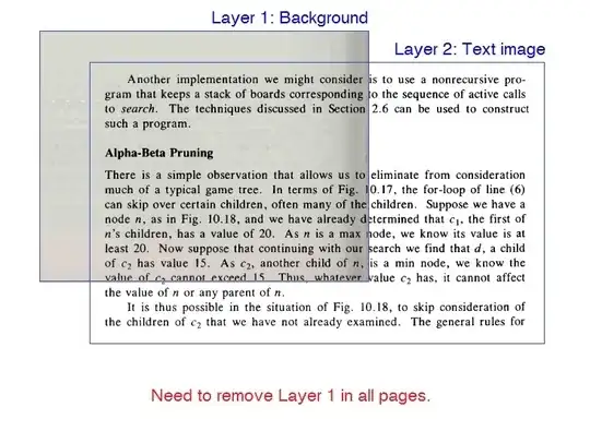

My PDF contains 600 pages with images of text. It has 2 layers.
  • Layer 1: Background colour image
  • Layer 2: Text image

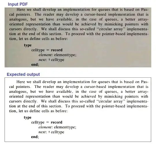

I would like to remove all background image layers in the total PDF file as shown in the image.
Could you suggest me any software/tool?

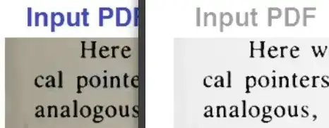

You can use convert or mogrify (in place). Just one command:
mogrify -type grayscale -gamma "2" -normalize -contrast -contrast -contrast foo.pdf
Changed the mode to grayscale, gamma correction to 2, normalize (check also -auto-level and -equalize; -normalize is equivalent to -contrast-stretch 0.15x0.05%), some contrast.. The result with your example:
screenshot
