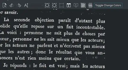

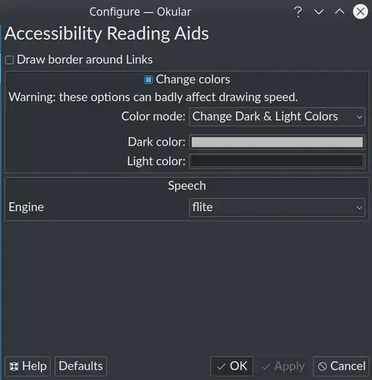

Beside the older setting of inverting colors (which might not work on scanned documents anyway), in newer versions of Okular (like 1.9.3) both font and page colors can be edited — and a dark-mode look can be enabled — through a new and rather non-intuitive setting, under Configure Okular - Accessibility - Color mode: Change Dark and Light Colors, by selecting a light color for dark and a dark one for light color option.
Then, for easy access, configure toolbar and add Toggle change color (Icon can be manually added/edited). It works for picture/scanned pages too.
This setting is a bit odd because of the names used.
Depending on the type of pdf, the color of the text (that is, the "Dark Color", meaning font color, which was set to a lighter hue) may change in part the color of the background, which thus becomes lighter than the selection under "Light Color" (meaning background color). This happens rather in some scanned documents, but not in all. It may be related to gray or colored backgrounds, which can be changed as said here.
