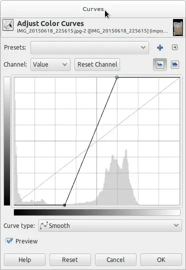

Personally I usually just use GIMP. But you need some basic skills to reach your aim.
sudo apt-get install gimp
  1. crop the picture in the wanted way
  2. use the Colors -> Curves option to manipulate the color output in a way you want it...
Adjust Color Curves to get a nice clean output.

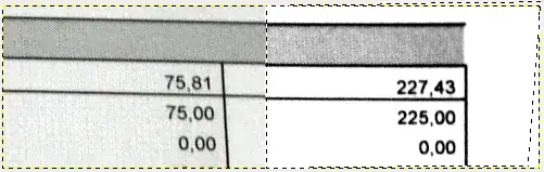

  2. Consider desaturation to greyscale for better contrast and removal of coloured pixel artifacts.
  3. Adjust brightness and contrast to make the presumably grey background white, and the black letters pitch black.
    • This can quickly be done with the Gimp Colors > Levels tool where we can drag the black point (left) and the white point (right) or pick the black/white points with the color picker.
    • Shadows on bent corners may no be removed without also removing parts of the text (see 6.)

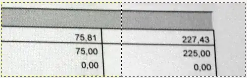

  5. Rotate and crop or perspective transform the image if needed.
    Unlike a scanner our camera may not get the source in parallel to the image borders. The Gimp Rotate or Perspective tool will give us a visual feedback to be able to rotate or adjust the perspective of an image until the text lines are in parallel to the page.
    Perspective Tool on the right side
Now we can select the document source with the rectangle select tool to crop the image inside of the document.
