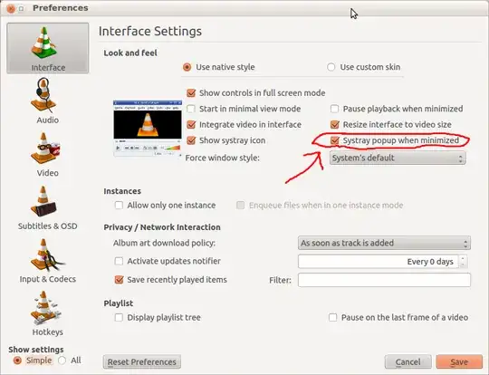

As For the VLC, you need to visit VLC Preferences (Press Ctrl + P, or access it from tools Menu)
And Disable SysTray Popup when Minimized (Hover the move over that option and read the descripton)

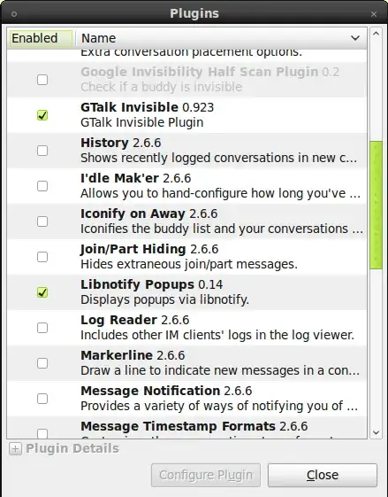

You can also turn off particular notification.To turn off pidgin notification,Open pidgin-->Tools--->Plugins
Uncheck libnotify popups there..

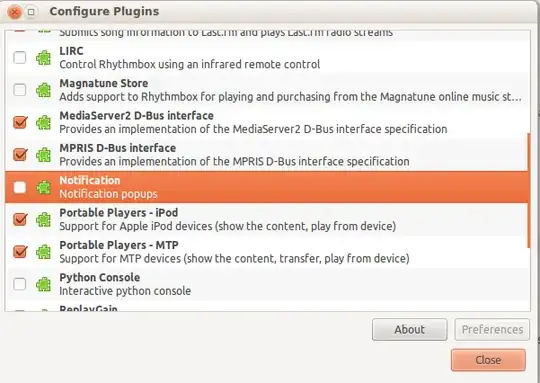

To disable rythmbox song pop up notification:
Go to:
Edit -> Plugins
and uncheck the Status Icon plugin.

You can stop song change popup notification form this
  1. Open Rhythmbox see in Menu: Edit -> Plagins (open it)
  2. Uncheck Notification plugin
